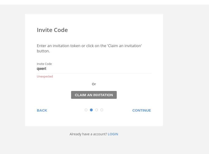

However when I try to run the Authenticator it seems to accept my (fake) token and allows me to enter and confirm secret and password Then hit ‘CONTINUE’ and I get thrown back to this…
Any clues @frabrunelle , anyone?
