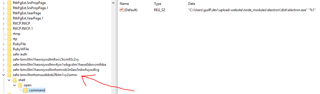

The first two times I ran web hosting manager I was able to see the auth pop-up within the authentication manager, but no longer.
Problem number two
The app that I’m building (simply meant to upload my website to mock routing), following the example, also uses shell.openExternal(..., which will get my open authentication management page to come to the fore but I’ve haven’t been able to get the the pop-up to appear.
let shell = require('electron').shell;
let safeApp = require('safe-app');
const appInfo = {
'id': 'net.safe.upload.mock',
'name': 'Host Website',
'vendor': 'hunterlester'
const containers = {
_public: [
'Read',
'Insert',
'Update',
'Delete',
'ManagePermissions'
_publicNames: [
'Read',
'Insert',
'Update',
'Delete',
'ManagePermissions'
const parseUrl = (url) => (
(url.indexOf('safe-auth://') === -1) ? url.replace('safe-auth:', 'safe-auth://') : url
safeApp.initializeApp(appInfo).then(app => app.auth.genAuthUri(containers, {own_container: true}).then(uri => {
shell.openExternal(parseUrl(uri.uri))
These two problems appear to be separate issues, but I’m not sure.
