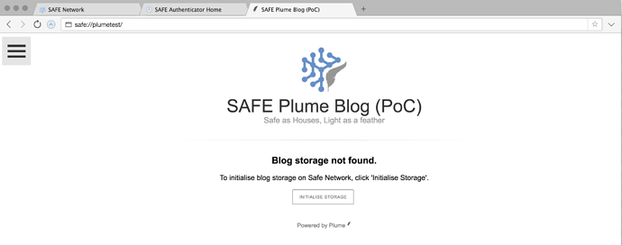

I’m getting the same issue with SB 0.10. @bochaco Please can you try visiting safe://plumetest/
Note: clicking INITIALISE STORAGE won’t work for you because it requires access to the plumetest publicid, but just loading the page I’m getting these errors.
In the browser console you can see the call to initReadOnly() which is what is trying to connect. This seems to work fine with mock.
Thanks
Hey Mark,

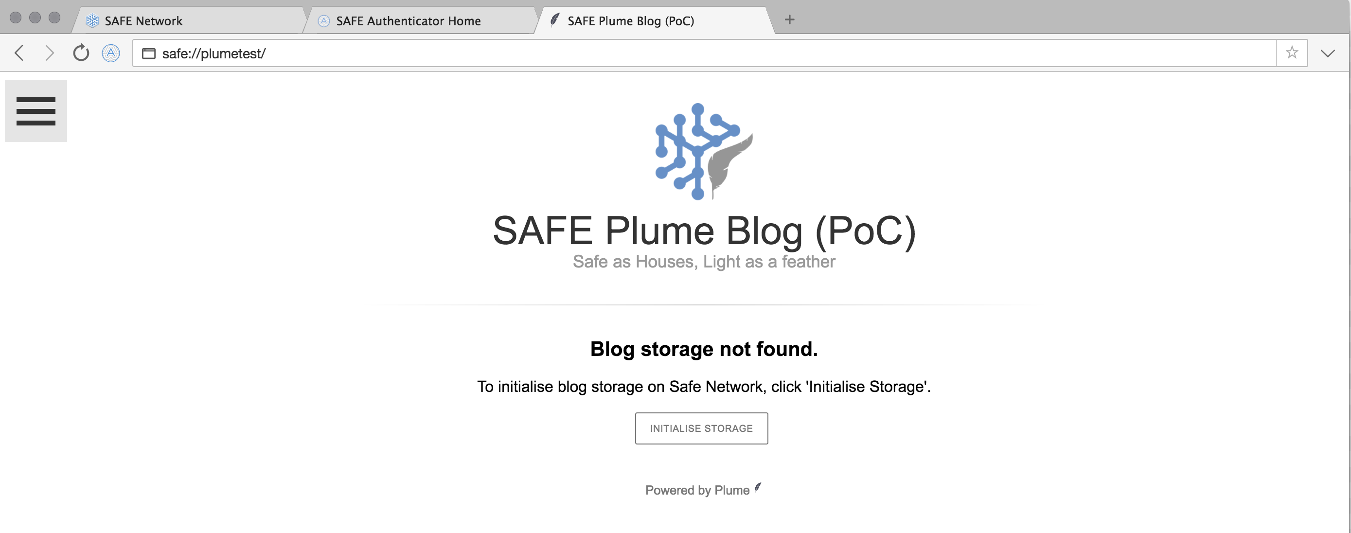

I am able to visit the site just now:
some of the proxy nodes are offline right now though (5 out of 25). Digitalocean have been patching their machines for the last few days for some security patches. @Fraser and @StephenC have been managing the process there to bring the network nodes back online after their maintenance windows but it might be a lil while before all proxy nodes are back online. Hopefully they can ping here once they get them all back online. Sorry it wasnt informed already as part of the post krishna made for the invite-manager status
I was also able to just loaded, I don’t see any error on the webapp’s console, so it seems it efectively loaded well and fetched all data

@Viv please can you check the browser console for errors (or not) shortly after it mentions initReadOnly?
I also get the website displaying (as you posted), but the issue is visible in the call to safeApp.connect() failing (error shown in the OP).
Thanks for the speedy responses. I hope digital ocean are back soon so I can test this. :-/
Update: OK @bochaco, thank you. Maybe some connection issue here then. I will try again later.
