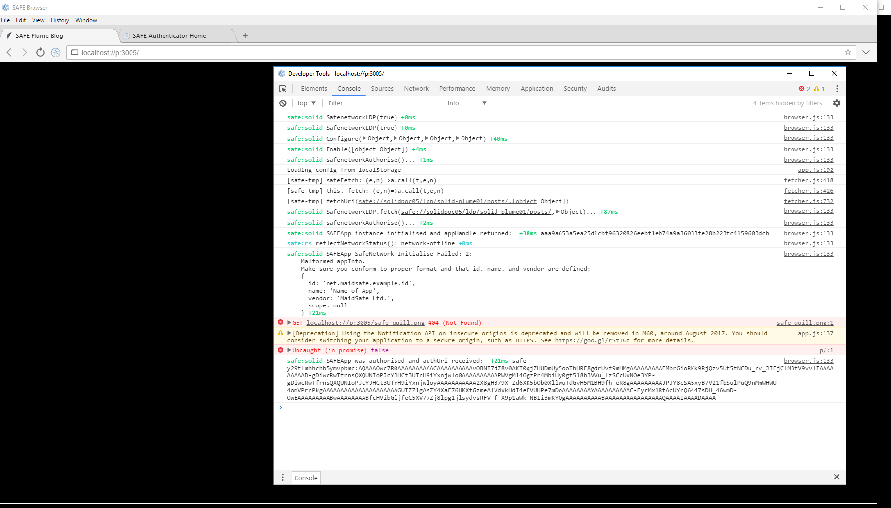

I’d like to find out why the app appears to connect successfully but is then logging a malformed app info error.
I also want to understand why the web view is crashing, see the black screen in the background.
I usually reproduce that crash when I attempt to use fileReader methods to read a file buffer, however, it seems to be a different case here.
I get this too but don’t think it is a problem (its a bug I fixed earlier, not sure why it is back! but it is probably trying to auth twice - first fails - second succeeds, so not the real issue here, but I will look into it). Update: I was getting this earlier and did make some changes which may have stopped it, but it is now back and I don’t understand why I get this. Earlier I was sometimes calling before being logged in to SAFE (live) but I’m logged into SAFE (mock) and its happening. So this is in fact unexplained, though not necessarily related to the OP error.
I do NOT get the tab crash though. I have my web app running ok and can interact with it to reproduce the bug I describe in the OP. I’m just not sure yet how to use peruse / yarn dev to delve into the safeNfs.create() error. I looked through the browser sources pane but can’t see much to do with SAFE yet. Any tips on that appreciated. No worries if you don’t have time.
Update: Your tab crash might be that you’re using SAFE Browser (yes?). I’m using Peruse. There’s a bug in electron (using SB built for mock) and one of the reasons for the switch to Peruse is to avoid that crash!
