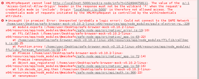

I can get the Safe Web App Tutorial to build but I get these errors running it.
. The second error occurs after authorisation.
I am also getting errors. @bochaco suggested trying to run it on the live network for now and is going to troubleshoot with me in depth on Monday.
I got a LOT further when I made sure my npm and node were the latest versions, but still having no luck in actually seeing the the two initial trips hardcoded in the tutorial - or manipulating them in any way.
Been busy with other stuff today, hope to have another crack at it later tonight.
@JPL, the first error can be ignored for now, as per the second one it seems you are facing the same issue as @southside, I cannot reproduce that myself so I suggested him to try it with alpha-2. The app should work in any network, and you seem to be having issues with connecting with the mock network (note that the app won’t be able to work unless it connects successfully to the network). I’ll be available this afternoon (going for lunch now) for doing a HO with both/any of you, please PM and we can troubleshoot it together.

Hey @JPL, we just finished a HO session with @southside, and the problem he was having was that he was setting the NODE_ENV=dev var from a console but then running the mock browser from another console, and that’s why he was getting this connection problem. You need to make sure that you run the browser from the exact same console as where you set the env var, you can run it like this as well NODE_ENV=dev ./safe-browser. Please try this and/or let’s go in a HO and we can do it together.
We are trying to have this sorted out in Peruse so you don’t really need to set any env var when running the mock browser as it is very error prone for users as we can see it here, we want to have a switch in the Peruse UI to go back and forth from mock to prod network.
Aha. Yes I was doing that too.
Right, ok, then make sure you run it with the command I shared above from a console within the mock browser folder, it should be ok.
