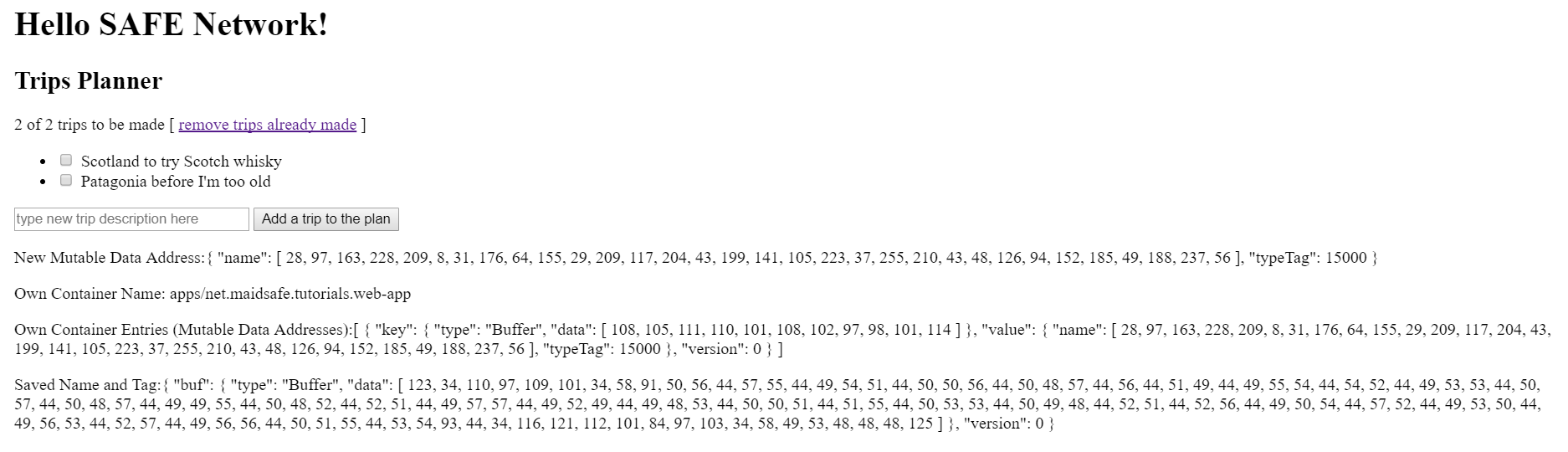

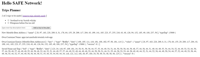

I’ve managed to save the MD address in the app’s own container, and printed this out to the html by printing the entire contents of the MD, so I do at least know it’s there.
The problem I’m having is with the get(key) function. I seem to have got the code working so that it doesn’t throw an error, or respond that there is no entry etc. but it’s just returning some empty curly brackets each time instead of the value. The same happens with or without the experimental features turned on.
