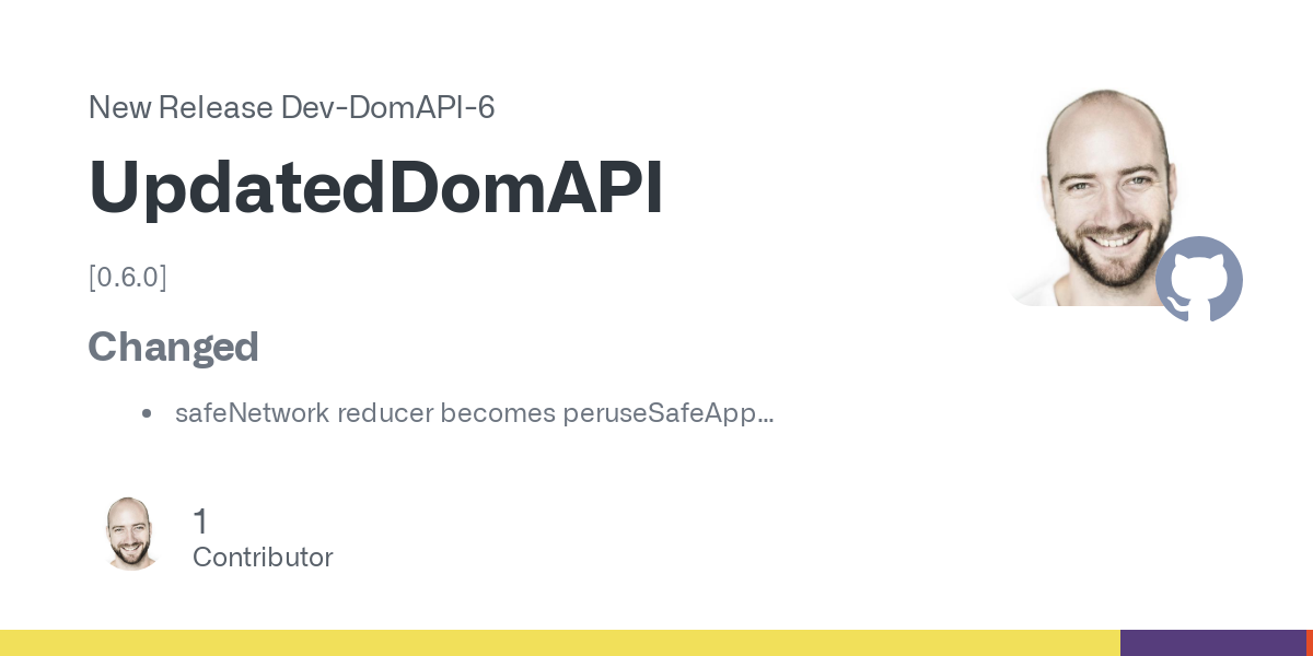

Can you try with this version of the browser please:
I think the eval override came in with the webId POC stuff (I think). So that version may go for you. If that is the case, we’ll need to update the example.
