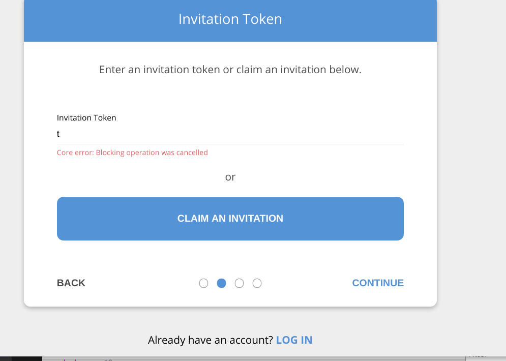

I have an internal network of >30 nodes running on a couple of machines in my LAN but cannot connect. The authenticator times out with the following
My safe_vault.crust.config for all machines is as follows
"hard_coded_contacts": [],
"tcp_acceptor_port": null,
"force_acceptor_port_in_ext_ep": false,
"service_discovery_port": 44444,
"bootstrap_cache_name": null,
"whitelisted_node_ips": null,
"whitelisted_client_ips": null,
"network_name": "local_1",
"dev": {
"disable_external_reachability_requirement": true
My safe-browser.crust.config is
âhard_coded_contactsâ: [â127.0.0.1:5483â],
âwhitelisted_node_ipsâ: null,
âwhitelisted_client_ipsâ: null,
âtcp_acceptor_portâ: 5483,
âservice_discovery_portâ: 44444,
âbootstrap_cache_nameâ: null,
âforce_acceptor_port_in_ext_epâ: false,
ânetwork_nameâ: âlocal_1â,
âdevâ: null
All machines are running Ubuntu18.04. The browser is v0.11.1 unzipped from the downloads page and extracted to safe-browser-local, I am starting the browser with
DEBUG=safe* ./safe-browser --debug 2>&1 | tee debug.txt
For an invitation token I just typed a single char and for Account secret and password I just pasted a random string from my terminal four times
What simple thing have I missed?

14:28:56:055 Remote Calling: createAccount
14:28:56:058 Handling remote call in extension { args:
[ 'rustc rust_tuple_tut.rs -A warnings',
't' ],
14:28:56:058 Handling create account call from webview.
14:29:23:041 Webview focussed: Triggering click event on browser window
14:29:23:058 Webview focussed: Triggering click event on browser window
W 19-02-16 14:31:58.220650 Failed to receive response: Timeout
W 19-02-16 14:31:58.220924 Could not put account to the Network: CoreError(Operation aborted - CoreError::OperationAborted)
14:31:58:226 remoteCall createAccount was rejected with: {"error_code":-14,"description":"Core error: Blocking operation was cancelled"}
