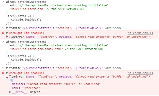

When I try to use the webfetch in Safe API Playground I get this error:
And when I try to use the web fetch code from the Docs I get this error:
This is very likely to be due to an issue which is fixed now with the MockVault
file. Can you please try to remove the MockVault
file, upload your webpage again, and then try webFetch
Where is the MockVault file stored ? I checked Web Hosting Manager’s and Safe Browser’s folder and contents as well as the as the windows App Data folders and had trouble finding it.
Use this doc to find where MockVault
is stored on your platform: temp_dir in std::env - Rust
