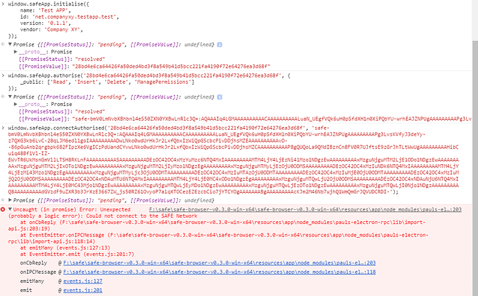

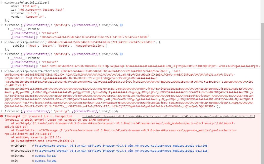

After many attempts I have tried calling each api function from the above auth() method individually and documented the following error which occures in the connectAuthorised function:

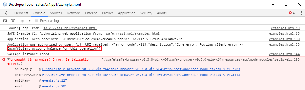

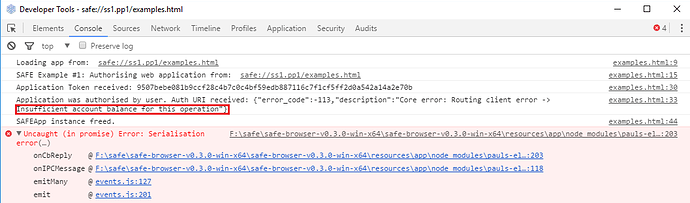

BTW: This was absolutely reproduceable, but now I get a low balance error when calling connectAuthorised (why does this touch the balance?), so can’t test it any further.
I’m getting the same error when I try to use connectAuthorised() directly after authorise() initialise() with an authURI I stored previously. Then if I try to do another API call the browser will crash.
The error you were seeing is due to the limit in the number of clients, please look at this explanation here.

@Mindphreaker Following up with more information about low balance issue.
What’s expected, and confirmed, is that tokens are needed to initially register an application that has been authorised, in order to create and configure it’s access container. However, upon subsequently connecting an app that has already been authorised and registered, it will not cost tokens.
