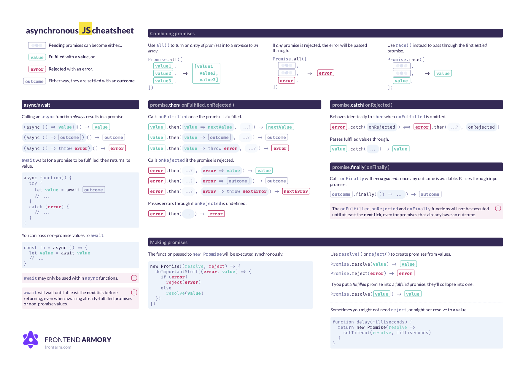

I just stumbled on the following async cheatsheet that could be useful.
