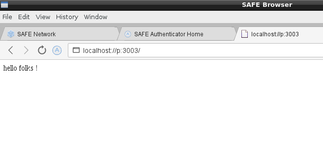

Aha, this sounds like the webview has crashed in the browser.
What are you loading? And is it a server that might be doing websocket requests? I’ve had a bad time with some versions of webpack with hot reloading. But there are workarounds if that’s the case. (I still haven’t been able to pin down exactly what is crashing the electron process)
Hmmm, on a second reading that might not be it, @happybeing.
Something to try is, instead of using localhost, if you turn off SAFE Browsing in the file menu, can you access the site using the normal http://localhost:<port> url?
If you have a link to the code in question (feel free to pm me), I can give it a run and see if I can see what’s up.
That made no difference, but the code I’m running is here, in ./deploy I’m running ws . -p 8000 and then visiting the URL localhost://p:8000
Thanks! :slight_smile:
Okay, it is indeed the webview crash :frowning:
I’ve filed an issue with electron for this a couple of weeks ago: Custom protocol + Origin headers/request crashes BrowserWindow/Webview · Issue #10314 · electron/electron · GitHub
I thought it was related to requests and access-control headers, but it doesn’t look like you’re doing any. It’s for sure related to remoteStorage.js (taking it off the page and it loads). So that’s helpful.
And to be clear, this is related to the localhost protocol. So if it’s live it’ll probably work. Just super not helpful for local development. :frowning:
But this at least gives me something more to debug against to see if I can find more of the why as to this happening.
