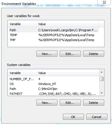

Your system path environment variable seems broken because some essential parts are missing. Here is a screen shot of mine:
Hmm IDK, my screen (above) even looks very different from yours. I have “User Variables” and “System Variables” sections.
Win7. Don’t know which ones to modify to make things work better
Select Path in System variable and then click edit. @polpolrene has shown a screen shot in this post including C:\MinGW\bin part.

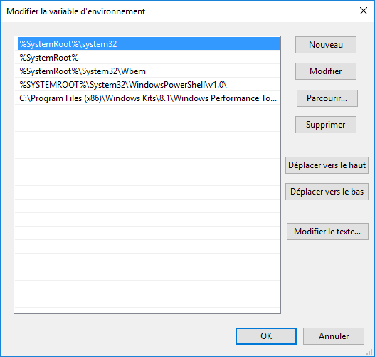

You need to click on it (path) and then click the edit button to see what it is set at. I am not a win user but this part seems that you will need to click edit to see it and ofc change it if needed.
I thought you can see it there, C:/MinGW/bin

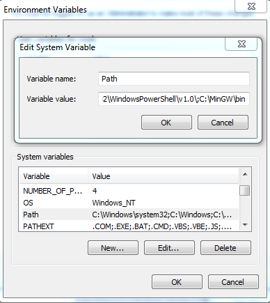

I’ll edit it also
In windows 7 and windows 8.1 edit the Path is different that windows 10. You highlight “Path”, press edit and add the new Path in the end after a semicolon. Somethink like that:
%SystemRoot%\system32;%SystemRoot%;%SystemRoot%\System32\Wbem;%SYSTEMROOT%\System32\WindowsPowerShell\v1.0;C:\MinGW\bin
@WhiteOutMashups, Your use / instead of \ and ,possibly, broke your windows deleting system path. Copy the above text in the path to restore.

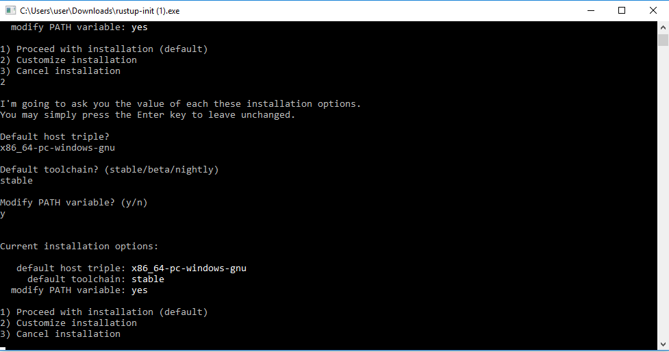

I’m not gonna put loads of energy into this but did give it a little try. When you install Rust make sure to choose custom install:
“Default host triple?” should be answered with the GNU version as in the screenshot. That’s even needed while you already downloaded the GNU version of the installer :laughing:.

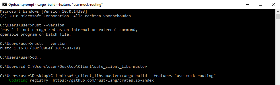

I downloaded the latest core and started to build it with mock routing:
I got this error at the end:
